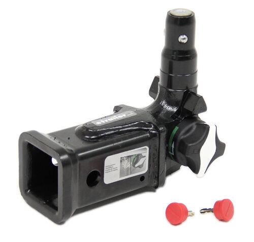

I really like the design of the Westfalia hitch and how it actually goes in to the VW's frame (unibody) rather than just being more surface mounted (under the bumper cover) like a lot of other models I've seen. I guess I'll have to see if someone makes a compatible 2" ball for their detachable unit or preferably a more standard to North America 1-1/4" "box" style receiver so I can use my existing bike rack (but with something similar to the Westfalia's superior mounting design).
Jul 23, 2015
5
Basically, I'd need something like this Bosal BSL043964:
But I believe this unit is only made for their truck tow bars (and doesn't seem to be readily available).
