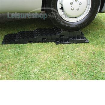

Arrived on site yesterday and pitch slightly sloping so levelled up the caravan only to find none of the holes lined up so had to start all over again with levelling. Right pain in the rear! I can see us dumping the Alko secure most times and only using it when in storage. Makes you realise that the person who designed it has never been caravanning!
4,638
What you need are levelling blocks that are level at the top such as the Milenco ones in this pic from Leisure Shop Direct
You can move them from behind the wheel to in front until the wheel is in the right position before adding the top block(or not)
I have the Fiamma ones but they are no longer available nor do they have the tyre saver top block
http://www.leisureshopdirect.com/caravan/chassis/product_48142/Milenco_Stacka_Level_6_(with_Bag).aspx

Not sure if they are suitable for a twin axle. Otherwise they seem to be the answer as you can still move the van to line up the receivers.

I use 39" x 4" x1" wooden planks. Both wheels on my TA fit with room for manoeuvre. So once I am laterally level I can still move or drag / push with no problem.
