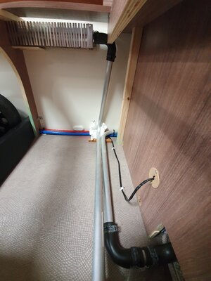

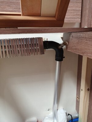

I purchased a 2018 Bailey Unicorn Cadiz in 2023 which had only been used six times abs was in immaculate condition. I took it to the company I use for a service and they pointed out that there was a fluid leak on the Alde heating system at a rubber elbow hidden behind a support in the lower rear o/s locker. Just in front of the rear washroom. Fluid had travelled across the floor and damp testing showed it was soaking wet.
On close inspection stains from both the pink and older blue fluids were present so the leak had been there for some time. The problem was caused by a failure at the bleed point where the valve was bonded to the elbow. It looked like the valve had been rotated and the bonding had given way. As the valve was installed out of view I had to cut away the end of a cross member and was able to move the whole radiator assembly to the left so that the valve was now accessible. Here's the rub. I contacted Bardsea Leisure and explained the problem. They had obviously changed the fluid but had not identified the cause of the leak. However, the blamed Bailey for the failure. I contacted Bailey and they would not accept responsibility as it was out of warranty.
So here we are with so called highly professional and well established companies acting like scoundrels. This behaviour brings disrepute to the industry as a whole and shows the caravan industry is no different to any other bunch of ************ think of a word!
Fortunately, the fluid had mainly leaked above the plastic flooring and was trapped between it and the clear plastic protective sheet velcro'd to the floor so it all dried out OK in the end. I drained the fluid, replaced the elbow that had been damaged at my cost, then filled and bled the system. No help or support from the manufacturer or the local dealer. Thanks for nothing Bailey and Bardsea.

Fortunately I was able to fix the problem but it is a sad reflection on the industry where a fault caused by them, manifesting itself years later is ignored.
Here is where the elbow was hidden behind a cross panel.
