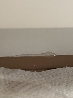

Our Bailey is brand new but water is seeping from an interior trim under the front window. The dealer has replaced the window rubber which had a kink in it but the problem remains. Water tests with hose did not produce seeping, however light overnight rain did! Any ideas?

Welcome to the Forum Marilyn. Very sorry to hear you are having water ingress issues with a new caravan
Identifying the point of water ingress entry is not easy.
The large panoramic window if not correctly fitted can be hard to seal against the "rubber" section.
It is not uncommon for new seals to be defective. The seals on mine come with a built in sealant mastic which sets once installed. This sealant can be faulty.
Back to the Dealer for more attention.
Remember the Law is on your side. How long have you had the Bailey ?
The Consumer Rights Act 2015 is your best friend. Plenty on here about that and the solutions open to you if the Dealer doesn't fix the problem.

With the use of GRP materials it's easier for water to come in from somewhere else and run down to another place without leaving a trail of it's route. As above, it could well be a panoramic window (or somewhere else) and the water is just collecting against the front window seal. I suspect the dealer just used a hosepipe around the window that he replaced the seal on, assuming that was the culprit, a better bet would be to hose the caravan down from above and have someone inside looking for where the water's journey starts.

I know the dealer is trying his best to effect a good repair but I am not convinced the kink in the window rubber was the problem. Could it be the grab rails? Their position on the front coincides with where the leak is inside. Why is water bubbling upwards from behind a trim? Surely water tracks downwards?

That's a very sad saga for a new caravan. Water has an uncanny ability to travel from areas where least think.
This is the Dealers second chance to remedy the problem.
It's your call.
You may wish to put the Dealer on notice that if the problem is not permanently resolved then under CRA 2015 you will reject the Bailey and demand a full refund.

It's refreshing to hear that a dealer is trying hard to keep the customer happy, but at the end of the day a caravan is an expensive investment and you need to be 100% confident that it actually keeps water on the outside!
Part of my job sees me investigating High Voltage cable failures and a fair number are down to water getting into the cable joint where the water has travelled for several metres, getting past a large number of obstacles and barriers until it gets to it's final area of destruction. This shows that although you are seeing water in one area it could well be coming in somewhere further away as has been mentioned by others.
