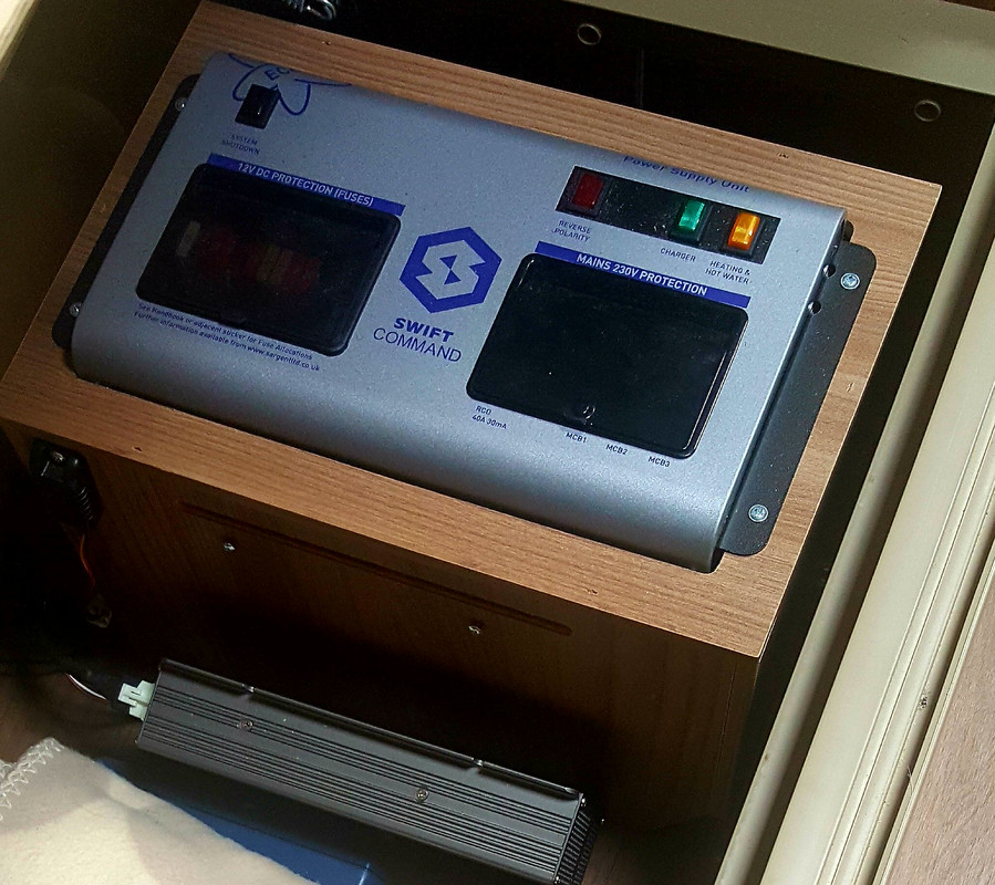

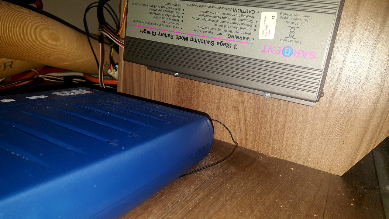

You should have a main switch where you pur the main power on ( mine's under the seats at the front ) but you should have some kind of silver box which looks a bit like this on mine , yours could be different and housed in a sort of plastic boxing or something like that
That's mine hanging off yesterday when I was in emptying the van but it's now secure like the top picture .

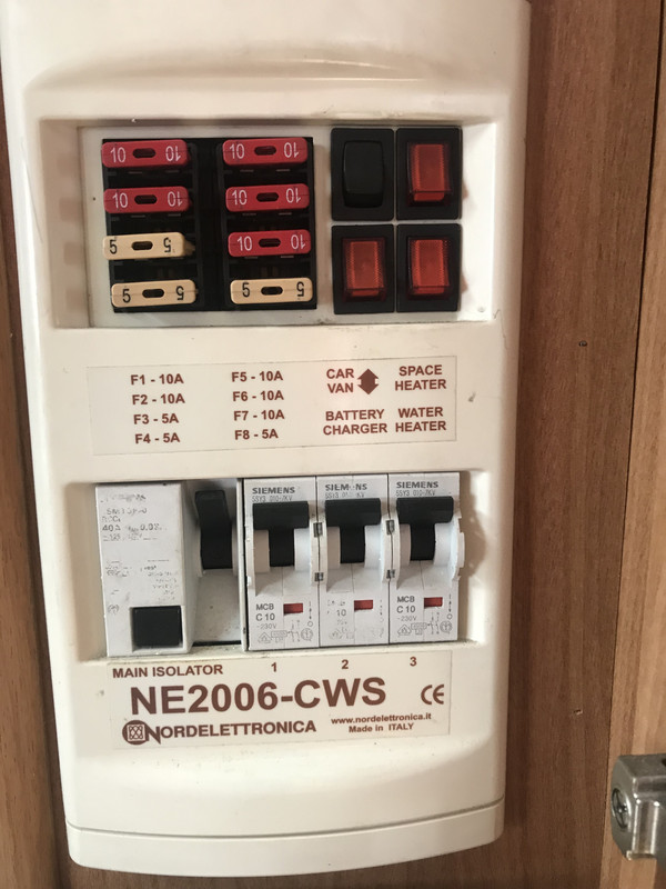

We have fuse box in cupboard photo below.
We have the rocker switch on charger all the time (off at moment as disconnected battery to put on charge).

Oh dear, unfortunately you have the infamous Nordelettronica system which is well known for being very problematic.
There were so many failures of this particular system that it bankrupted the company that made them !!!
However, there is hope.
If you contact Paul at Apuljack Engineering he will be able to help by repairing your unit to better than new, but it will entail sending items to him, and I think that will be the large unit as per your photo.
He will talk you through some checks to make and advise what needs doing, and he is THE best with these units.
See here to contact : http://www.apuljackengineering.co.uk/
Looking at your photo you have all the red switches in the OFF position , presumably you have had them in the ON position? and nothing changed?

Hi
Yes they were on the on position with the black rocker one set to van position.
Only off currently as battery disconnected as being charged we managed to borrow a charger.
