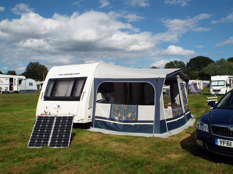

Try to get wires, ideal 4mm or 6mm, connected to the battery wires, then using Anderson connectors you can connect to the solar panel wires. I could not get the croc. clips onto my battery, no room. However my caravan does have a 12v / 10amp solar socket in the battery locker, so just put a plug on, Anderson connectors are the grey things on the left. However these 12v plugs are not very good they can come loose so looking to wire direct to the battery wires; I can get to them under the side seating and connect up there, then just plug in. I use a 150w folding panel, gives out 8amp in full sun.
