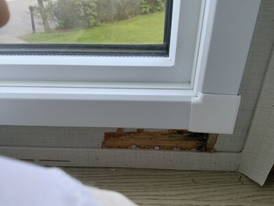

I have an issue with our Carnaby Ashdale 2019.
We originally noticed two soft spots at the bottom corners of two of the front windows.
I was advised to seal around the external windows for which I have done.
I have now attempted to make good the soft spots but I am now faced with rotten timbers, one side is worse than the other and looks like it could have been happening longer than the 12 months we have owned it, but sadly we have not noticed this problem within the 3 months warranty that the site give you.
Anyway to cut a long story short, has anyone experienced this problem and how did you fix it.
Could the windows leak from the black rubber gasket on the outside of the widows. Please see internal pictures.

Sadly the only proper way to deal with such an issue is to remove all the internal wall boards untill you expose good timber, remove and replace the rotten parts and then replace the wall board. The windows will also need to come out and be re sealed when replaced.
Often the damage travels further than first indicated.
It's not really a cheap job either.
Sorry to be the bearer of bad news.
