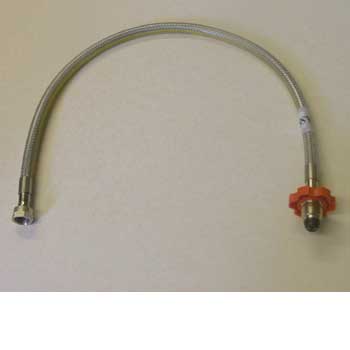

You do not say what fitting you need but most fittings can now be purchased with a hand wheel, this does away with the need for a spanner and makes the changing of cylinder connections much easier.
Example of Calor propane hand wheel pigtail below.......

Thanks, Gafferbill. Yes, I have fitted a handwheel but it's still a pain getting in to it and the thread is still 'touchy'.
Furthermore, it never 'seems' secure to me. Is the hand strong enough to securely tighten the connection???
