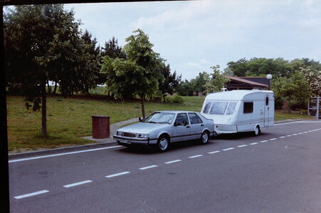

I had rear end kitchens in an Eldiss and ABI, but never had any concerns wrt towing stability. They were two berths and not particularly long caravans. The tow car was Saab 9000 using a Bulkdog lever spring stabiliser.
