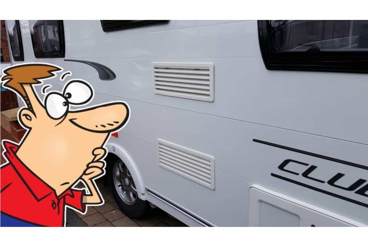

I’ve always used the covers in winter and off in spring and summer. This link goes a long way to explain the physics involved.
We have them on our caravan during the winter as it makes the fridge more efficient plus it may help keep out some unwanted guests.
