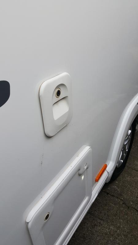

For the bit where yous are saying you put screen wash into the tank do you put it into this bit you mean where you would normally put the flush water ? (obviously the top one)
Craig

Yes then I pump some through into the cassette. Then empty cassette. Beat intellitext thos tome :)
Understood - apart from the last sentence :unsure:
So is it everytime you drain down and leave standing or for people that leave for months at a time parked up unused over winter , does it make a difference if I don't do it saying that we are out every 5 weeks in ours through the winter anyway ? I've never done it before I never had a problem but dont want a problem either .

Go back to Parkys post and it should become clear. I will stop deliberately doing it now, but cannot rule out hitting 'i" instead of 'o' when I use my phone.

In answer to your extra question I tend to do it during winter even if the van is being used. The weather can change quickly and drop down below freezing. Some just keep a pink solution in the tank but I don’t know what it’s anti frost properties are but anyway I drain down water before a journey and just leave 1-2 litres in the flush for on journey breaks. But that gets drained down on arrival home.
