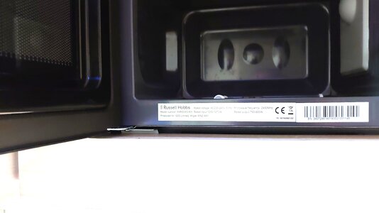

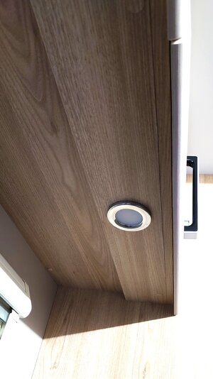

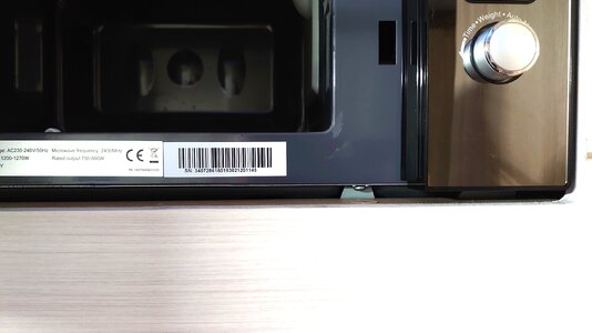

Hi Dustydog, I've had another look and that doesn't seem to be the same as the Avante. I've taken some photos to show what my set up is. The photos show underneath the shelf and the screws when the microwave door is open.

Thanks. Are you sure there are no hidden capped holes / screws on the underside shelf? If you have removed the top screws is the unit still securely fastened?

Thanks Echodale. Can you tell where the stickers are located? Are they underneath the shelf? I can see one in my photo of the underside of the shelf but not two.

I cannot remember exactly where they are but they are hidden inside "door" I am short so had to use the caravan step to look down and a torch. I can see that sticker in your photo might be worth peeling it off, as these are hand assembled it may differ slightly.

In the first picture (showing the wood and under shelf light) if you look carefully near the top and the bottom of the picture you can see two wood effect small round features which are almost certainly the access screw covers.
