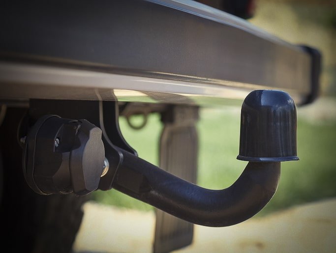

Just to be clear it is not us with this issue, but an acquaintance. They bought a old Landrover Discovery recently from a dealership to tow their horsebox. On a dual carriageway travelling at about 50mph the horsebox parted company from the Landrover. The detachable towbar had detached itself from the vehicle for no reason. Luckily the breakaway cable reacted and braked the horsebox saving their lives and perhaps the lives of others. It was a towbar that was a standard fit on Landrovers of that age and done by Landrover.
On contacting Landrover regarding the issue, the new owner was informed that Landrover had issued a recall on that type of towbar and ball and replaced the detachable with a fixed towbar. Obviously the previous owner had not taken the vehicle to Landrover for the recall.
As the towbar was visible to any MOT inspector without needing to remove anything surely at sometime the recall should have been picked up at a MOT at some point? Also as bought from a dealer is it now the responsibility of the dealer to replace the towbar of offer a partial refund?

I remember the 2014 Freelanders had recalls on the removable towbars, due to vibration wear on the locking parts.

Mine is detchable, but has remained firmly attached and locked for over three years .
They are not the easiest of things to attach unless you have the learnt the knack. IMO I think your mate will be hard pushed to prove who last removed and attached the tow bar. How “old” is this Discovery?

He bit the bullet and paid for a new towbar to be fitted. However it could have been a serious incident except breakaway cable saved the day!
