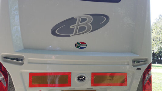

Does anyone have any wisdom to share re fixing the marker boards to the back of the caravan?
I think I'll be ordering the two smaller ones, and my bailey caravan has the towel rail type handle along the back.
i have done a search on this, and using a zip tie with holes drilled through the red border seemed a favourite a few years ago, but maybe things have improved?
Thanks again. This forum is a great help.
Jul 15, 2008
3,908
1,094
I use the longer board as it fits across the long Swift logo on the back of my caravan. It is secured with 3 well nuts and bolts which are hardly noticeable whether the sign is fitted or not.
Can fit it or remove it in 5 minutes .
Probably not a solution on a Bailey.
I believe some owners use white velcro stuck to caravan and plates.
