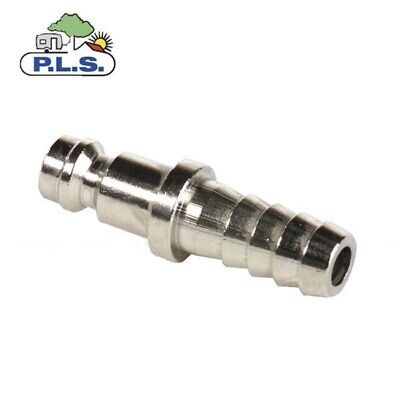

Welcome Ian, this is the type I have, go to a website such as lesure direct etc. Although my BBq a cadac states 1 meter hose, I use a 2 meter hose to keep well away from the awning and no problem.

There was a recent post where Dusty (I think) posted picture and link to a connector on his Bailey. I have used some like Hutch posted to be able to use different gas types and cylinder on my Cadac. Quick release so that I can use different gas bottle regulators.
