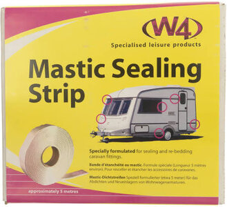

The outside Heki sky light does not have a water tight fix to the roof. When shut the inner section of the external frame sits about one inch higher. We have experienced , in heavy , windy rainfall some ingress but nothing to worry about. If yours is the failure of the original seal then you need to work externally on the roof to remove it. Not easy with. Years of weathered sealant. In fact it is possible the plastics will be so brittle they may break. There are some wide sealant tapes available for caravans. Maybe overlay the old sealant with one of these
