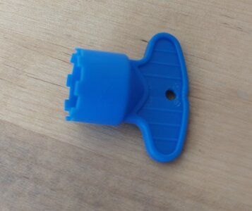

Hi. Just picked up new swift Conqueror. This blue key was on the bunch, but nobody knows what it's for. Any ideas. Thanks

Most caravan taps have mesh filters. Screw or push fit. OP must have a different tap that needs the special tool.
As Clive says you will need to clean your taps sometime.Doubt you will need the tool described

Thanks DD that the answer I was looking for my AWS caravan engineer can do that for me .
I have a Swift Alpine 2. Swift Tap ends are a bit notorious for shooting off. Does the tool help to press them back on as well as take them off?
BTW if your tap ends do shoot off, dry them and the tap end. Line up the notch with the flange and press hard. Do not try to twist
