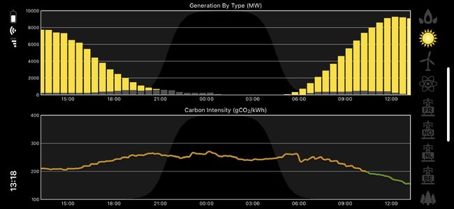

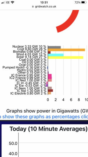

I am not sure when that article was from, but to give some context; here is the grid level solar and coal in the UK for the last 24 hours. The coal is the grey bit at the bottom of the yellow (solar). This does not include solar from embedded generation (i.e. rooftop solar that is behind a consumption meter). Its hard to conclude that the coal is there to replace solar generation lost to hot panels from this (especially as some of the coal generation was after dark). IMG_0180.jpg

I am not sure when that article was from, but to give some context; here is the grid level solar and coal in the UK for the last 24 hours. The coal is the grey bit at the bottom of the yellow (solar). This does not include solar from embedded generation (i.e. rooftop solar that is behind a consumption meter). Its hard to conclude that the coal is there to replace solar generation lost to hot panels from this (especially as some of the coal generation was after dark). View attachment 4873

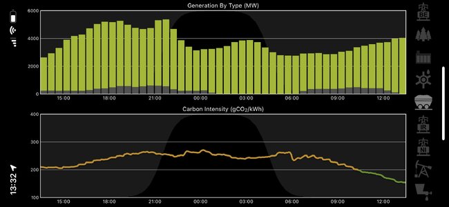

So the real facts are that lack of wind at night required some coal back up. No coal being used at this time.
Here is the same picture but with wind instead of solar. The way I read this is "UK electricity demand required that we leverage our diverse energy generation portfolio, just like normal". IMG_0181.jpg

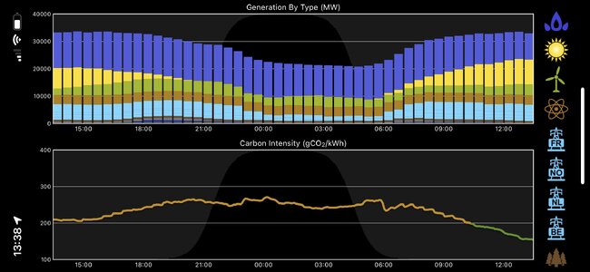

Here is a picture of the full mix.

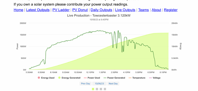

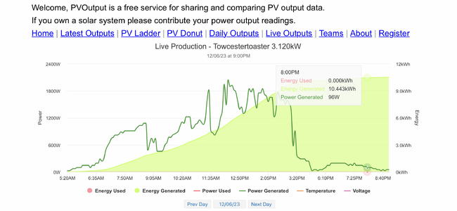

Again - just for comparison - here is the rooftop output from Saturday when we didn't have an afternoon storm (like we did on Sunday too). The wiggly bit in the afternoon is clouds going by and some haze building up, but output stays very strong to almost 7pm.IMG_0184.png
I also just noticed that yesterday, my peak output was just over 2kW. On Saturday (which was a cooler day) my peak output was just over 1.6kW. 🤷‍♂️

With hindsight, I should have posted the punchline to the BBC article question “Is it too hot for solar?”. The answer in the article is a clear “no”.
I am not sure that there are many panels deployed today coming to the end of their life. My panels deployed in 2012 are guaranteed to have lost only 20% efficiency from new after 25 years. So far they have lost 0% of my year on year production is to go by.
Heat is _not_ a serious issue. It has a small impact on efficiency, but it’s immaterial. I just checked the surface temperature of my panels, it’s 34C in full sun with ambient air temp of 23C. Panels have got more efficient over the years, but by as little as 5%. But here is the thing. Deploying _any_ panel is better (more efficient) than _no_ panel. Once in place the panel will continue to generate until it is physically turned off or decommissioned. Even if it degrades to say 50% after 50 years (which it won’t) that’s still infinitely more than no panel would produce…
