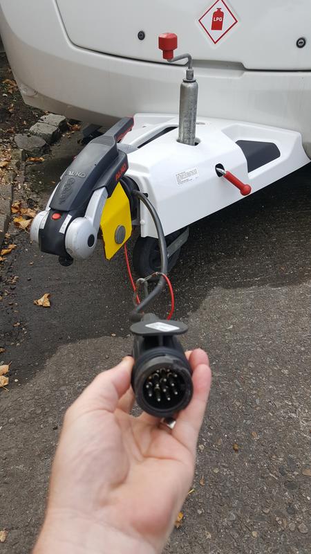

So, just been in contact with the dealer and they were asking if I wanted the electrical connection lead. (I would have thought this was included) however my main questions is this:
All the leads have a black 13 pin at one end and a black and grey at the other end. Now I am assuming that the end with 2 sockets go into the caravan end because the towbar i got fitted is a 13 pin one and only has one socket coming from the car. Have I got something wrong? (I would assume that a 13 pin cable would be one plug to one plug)
Help!!!!!!

Being a new caravan yours will have a lead from the van that has 13 pins. Your car has one socket. Is this 13 pin? If so you are okay. Alternatively is your dealer asking if you want the 240v electric hook up cable? These normally come as part of the caravan purchase with new vans. The other thing is that the lead with two ends and one other end being 13 pin is a convertor lead to go from a 13 pin van lead to a car with two sockets. One grey and one black. Unlikely you would need this one.

Our car has one socket next to the towball. So does the van NOT have a lead that runs from it to the car?
I couldn't see a lead available anywhere that was just one plug to one plug.

Your caravan will come with a lead fitted to it that connects the van to the car. The lead on the caravan is not detachable as it puts power into the van fir battery charging, road lights, ATC, fridge etc. It’s end with the 13 pin plug goes into your towball 13 pin socket.

Thanks - I thought this was the case!
So as I have 13 pin connection on the car, I don't need anything?

Yours should look like this as most will.
mine is also the same as what you are getting , one lead from the caravan straight to the back of your car for 13 pins . You should get an orange hook up lead to if not thats shocking pardon the pun, with the caravan as we did if you don't I would insist on one as you should get that

No , you should be able to plug in and go you don't need any two plugs or connection or nothing like that , one lead from caravan straight to your car .
