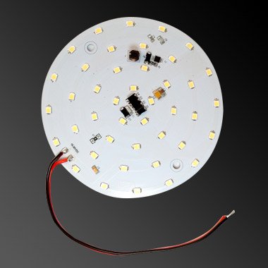

BB.
The existing fluorescent tubes need that block of "electronics" [inverter] to generate the high voltage AC from the 12 VDC the caravan battery supplies it with.
LEDs have totally different micro electronics integrated in the bulbs themselves. They can't work with the fluorescent's driver electronics.
So here you need to remove the existing electronic block thing totally, along with the tube of course.
You can then buy a pre built disc fitted with LED arrays, which simply connects onto the 12 VDC wires coming into the lamp housing.
This is an example of one of these discs from a very reliable provider. This one is 100mm dia and is of the "warm white" more like the light "shade" of colour from a halogen bulb;
They also do one with the harsher "cool white", our preferred for reading. The warmer suits more people from my observations.
That route is one practical solution. You can also make a daisy flower like flat disc arrangement by buying [say 5 off per light ] G4, side connection LED bulbs and the connectors. Like a 5 petal flower.
Or you can buy LED strip you can cut in pieces and mount on your own disc backing.
But I recommend you check if these pre-made 100 mm discs would fit.
However, first you need to see if you can "face" removing the existing inverter electronics, to basically only use the enclosure.
If the existing enclosure has a switch that is an important function to you then you need to check it can be retained, or we will need to get inventive.

I’ve used Aten led to replace OEM bulbs and they are a very good company and willing to discuss things.
The replacement led bulbs give excellent light.

Thanks everyone for really useful information - especially the contact to aten lighting, which I would have never have found without your help... However, the roundboard 100mm 42 led, might give out too strong a light in the small lounge area which contains two down lighters.... But no probs as they do a smaller round led with just 15 led and gives out 300lms, which might be sufficient. Any thoughts ? Also each ceiling light in my caravan is 20cms in dimension and the led board is only 4cm in dimension, so the led will sit in the middle of the backing plate but will be tiny. Can I assume the the emitted light will `spread` and will not be a `spot light` effect ?
I`m left with a feeling I can do this job myself once I have ordered the right gear.
Again thanks for you input - very much appreciated from a non techno person..
20,100
6,131
I bought a side pin flat led replacement that was a direct equivalent in lumens to the halogen bulb that was to be replaced. It gave as good a light as the halogen. If you know the lumens of your fluorescent lamp that would help you. But the flat round led did not create a spotlight effect even though its diameter is quite small. The obscure cover of the light fitting acts as an effective diffuser.
