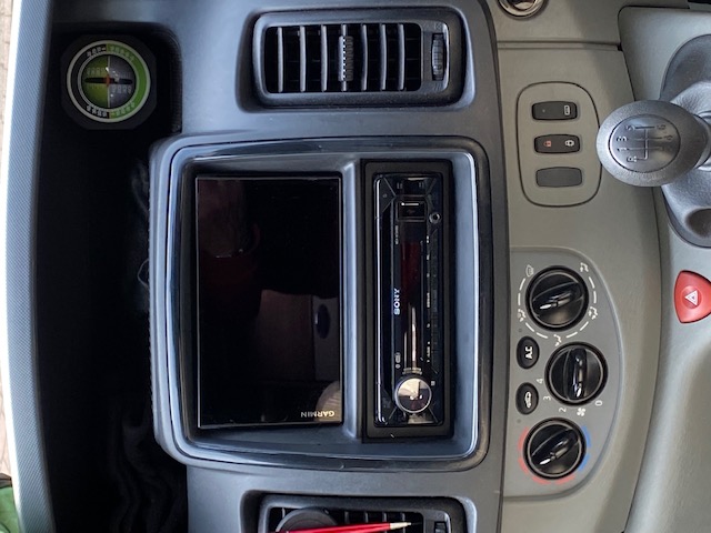

I wanted to share an experience that I've had with a recently purchased Garmin Camper780 SatNav.
I initially found the SatNav to be everything the hype said it was. I was replacing a much used but dated competitor's SatNav in my Motorhome and this time I wanted one that I could install it's dimensions.
I had also decided that I wanted to make the installation look more neat and to not have cables stretching across the front of the motorhome to a 12v Socket or USB Point. I'd arranged to have the SatNav professionally installed in the dash. The SatNav now looked like it was a standard fit and I was very pleased, no cables anywhere.
The initial install and downloads were done (although the updates did take what seemed like an age), but eventually everything was set. Everything was updated the dimensions of my motorhome downloaded onto the unit all ready for having destinations put in and away we went and "yes" it did exactly what I had hoped, routed us to a regular site we use but this time didn't try and send us by way of a very narrow single track road.
So where's the problem, you may ask. Well I've now discovered that one of the functions on the Garmin780 can't be adjusted. That being the level of Brightness on the Display. It remains at the factory set 40% which can be dangerously distracting at times.
I contacted Garmin Support for advice and suggestions, only to receive a cryptic reply stating that ONLY the Mini USB Cable that they supply will operate all the functions on the Garmin780. (I may well find other functions that cannot be adjusted)
When I had the unit installed it was connected to an existing standard Mini USB Power Cable that was in situ and, as I've stated, this allowed all the set up and downloads to happen, but unknown to me at the time, not all the functions were activated.
I went back to Garmin Support with a more detailed explanation stating that an Industry Standard Mini USB Cable had been used for the initial set-up and I found it incomprehensible that a Garmin Mini USB cable is the only power source that can used, and if that is their stance this should be made clear to any prospective purchasers of their SatNav.
I'm still waiting for a response, to this follow up.
To summarise; If you're going to purchase this SatNav please be aware that Garmin state (or that is the problem, they don't state) you can only use the Mini USB Cable that they supply to power the SatNav.

Firstly, thank you all for your comments.
Regarding the installer I've used them many times on a whole range of vehicles from cars, vans and my motorhomes, and completely trust their expertise.
Yes the SatNav can be removed quite easily and again yes the cable is then unplugged from the back of the SatNav exposing the Mini USB Connector.
The other unfortunate issue is that I don't have a 12V socket to try operating the function through that source.
My installer has agreed for me to take my motorhome back in so that he can check that the charging cable was type approved (although it had been used to power a previous, but now out-dated, SatNav).
Fingers crossed he'll get to the bottom of the problem, he's never failed me yet.
Thanks
Michael
