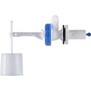

My intentions are to fit a side entry filling valve and float to the onboard tank to allow a Direct mains connection when on a service pitch to allow consistent water ?

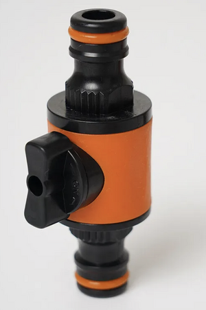

I have purchased a torbec valve to fit internally that will be connected by 10mm pipe which will be fed by a normal hose connection on the outside of the van with an isolator attached.
This will allow the onboard tank to have a consistent supply.
When on a pitch that is not serviced we will revert to the original method of feeding it., although the water would potentially fill higher than than the float at times.
The question i have is, can you see any risks To doing it this way rather than using a float switch and actuator to open and close a valve, as the basic plumbing materials are at no cost to me.
