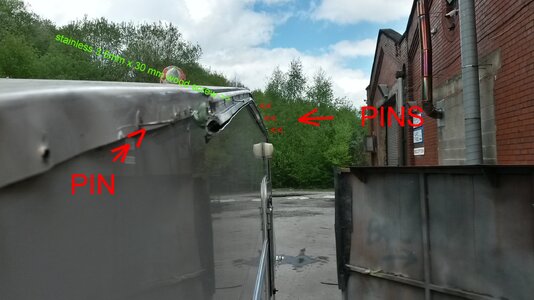

I've put a post on awning reseal under the "vintage section" it shows the method I removed,cleaned and refit mine.One problem that can show itself is that rain water running down the awning rail collects on the underneath corners where the end panels marry up to the caravan floor and collects.. It's a simple fix to stop it...Gary good luck

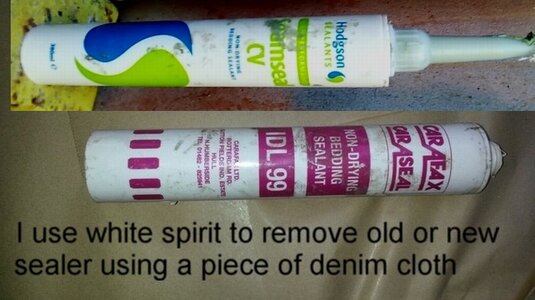

If you look at my post in the vintage section it may be of help.Caraflex is what I used on my 92 abbey rails.caraflex bitumastic allows the panels to rails to expand and contract and is a flexible seal.It was used by manufacturers.It was made near to Cosalt and swift etc in Hull.I've removed all my aluminium rails, battery boxes and what not...replaced all screws with stainless steel,replaced screw covers (Herzim strip) and side buffer strip..also I have several manuals for carver,Electrolux and spinflo,,,if your need any let me know I'll see if I can post them on this forum...good luck. Gary

Another tip from this forum when I did my major damp repair years ago was after cleaning with turps get yourself some methylated spirit and wipe over the area and it will clean the residue left behind from the turps. I did use the 512 on my van.
Rather than use a wire brush I used a piece of denim on the panels(so as not to damage paint) and a piece of copper pipe flattened on one end for rails.When applying new sealant on to rails I warmed the cartridge nozzle with boiling water crushed the end and cut it so enabling a flat bead to be applied
