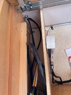

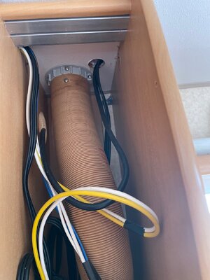

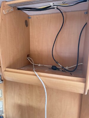

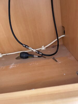

No terrestrial TV last two weeks away😥
Did a structured continuity test from the aerial via the amplifier back to the cable TV end. Dead between the amplifier and TV🤬.The cable disappears into a hole in the ceiling and comes out of another hole 6 feet away. Solution. Install a new cable. Impossible to pull the old one out.
After removing two panels and the microwave, eureka. Found the problem . A cable joiner behind the microwave had come apart! Must be all the years of vibration. A quick clean up and retighten, all working again.
Why on earth Bailey didn’t use a single section is beyond me. How would you know the join was behind the micro wave. Very poor design again 🙉IMG_1507.jpegIMG_1509.jpegIMG_1506.jpegIMG_1508.jpeg
