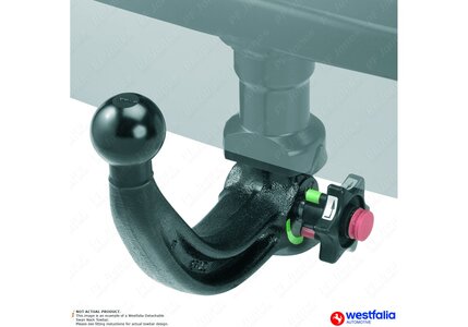

I have a westfalia detachable tow bar fitted to my car, normally it connects into the housing with out an issue. Today I tried to connect it in and it would not click into place. All moving parts seem to move ok , stuck my finger in the hole could not feel any obstruction.
I had to use a small hammer on the twist lock for it to click in place.
What am I doing wrong?
Thanks.

It's probably down to surface rust stopping the hook getting fully inserted. You might have an issue removing it now!
Once yiu have removed it look at tge various mating surfaces and give them a going over with a wire brush (the "V" sections on both appear to be tge offenders) once clean apply a smear of copper-slip or similar to prevent it happening again.
DONT be tempted to use a hammer ever again! there's a reason it won't seat properly, it's important to fix the issue rather than just using brute force!

My explanation was a little poor, the hammer I used was a little 1lb tap hammer. However the point has been taken on board not to use it again.
On the positive side, the bar dropped out without any issues.
I will buy some copper ease to see if this helps the insertion going forward.

Just be sure to wire brush all the surfaces before applying a light smear of grease.
I have had this type of issue before, hence my advice.
If the hook won't "lock in" with ease then investigate why!

Greases have to be used with care on these taper based fittings as they tend not to be "light" enough to readily flow out of the way enabling the taper to seat as deeply as is required.
It needs to be only used as a very light smear on the contact faces as stated.
Particularly here where because of the difficulties already faced, the unit would appear to be towards the tighter end of the manufacturing tolerances; in most respects no bad thing.
Personally I would use an oil rather than a grease, the characteristics better suit this type of taper fitting application.

May be too late and already covered but before you go too far down the wrong road just make sure that the latch is in the "unlocked" position before you try installing it. I had the same issue only 5 days ago. Once I ensured the lock was in the correct orientation the towbar engaged fully and very firmly.
