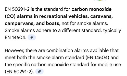

After much research I have been advised that your smoke / co2 alarms have to meet certain regulations, EN 50291-2, EN 14604.after having two fail in the caravan, anyone recommend alarms that actually last and don’t quit and 6 months ?

The topic of Smoke and CO alarms has come up regularly on the Forum, so I’d be surprised if regular viewers aren’t aware of the need for a specific type suitable for use in leisure vehickes especially as the new regs were introduced in 2019.
Page 1 of the Kidde manual (Introduction) says the CO detector hasn’t been tested specifically for use in caravans or boats, and gives the requirements for alarms that do meet the requirements for caravans and boats. Had I read that I would have returned it via Amazon.
