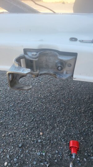

Looking for suggestions on removing a short bit of the jockey wheel clamp handle that has sheared off within the threaded hole. There is no bread left to attach another handle and nothing protruding to grip it to turn to remove it

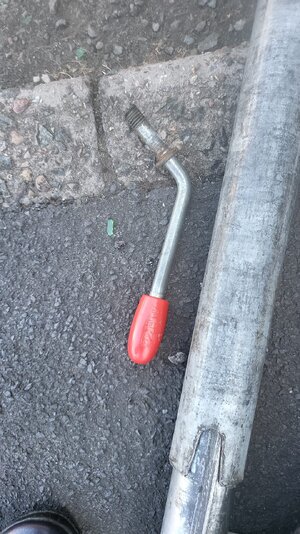

Exactly the same happened to me just after we arrived at a site near Grantham a couple of years ago. I doubt that the thread in the clamp is faulty, or crossed. It's probably metal fatigue from possibly overtightening the clamp. From the picture, the clamp handle doesn't look new, the handle that raises and lowers the jockey wheel looks new, perhaps it was this that the dealer replaced?
To remove the stub I used a 4mm HSS drill bit to drill a hole in the stub and, when it was deep enough, used a stud extractor (basically it's a screw with a reverse thread, so that when it gets tight into the stud, it unscrews it). I found it took a bit of patience, a steady hand to keep the drill bit central, and I used the stud extractor with my electric drill/screwdriver in reverse.

You need to drill the centre of the bolt and then use an Easyout to remove it. I would also give it a good soaking of WD40 for a few hours before doing so. If only they bolted these on instead of welding to chassis would make life easier,

In addition to drilling a hole in the stuck bolt, and trying penetrating oil, and in case these don't work I would consider the use of some heat onto the boss/nut (using a hot air gun with due protection for the A frame cover) to expand the nut a little.

If you know anyone who is handy with a tig welder, get them to tack a nut onto the broken shaft, then apply lots of plusgas and heat over a couple of days, should loosen up and let you wind it out.
Bit of anti-seize grease will help prevent the new item ending up like the current one.

The broken shaft isn’t seized as such as I’d been winding and unwinding it ok to move the ‘van and alter hitch height, I think the shaft just sheared from metal fatigue.
I’ll have a better look tomorrow with a clearer mind - I was furious with myself as I was playing shift the cars and caravans and everything went wrong (from flat battery, putting keys down to a neighbour parking in the space id just vacated to put one of the ‘vans. Then this whilst I was shifting it with the mover….
I’ve seen a different thread that suggest the retaining ‘bolt’ can be replaced… just need to work out how to remove it
Hoping the bit circled in red where the handle sheared is the rivet nut in the link.

If the original is a rivnut type of fitting then one could just knock it out with a decent parallel punch, then replace it with a new one.
