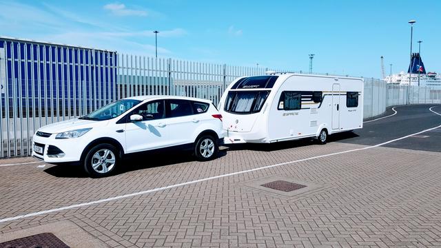

There'll be nothing wrong with your choice as you can see from my profile picture we also have the Ford Kuga 2L dCi front-wheel-drive 150 as have a few more on this site and there is more than enough power to pull what you'll (probably) need or purchase caravan wise as we have a big Sprite Major 6 and pulls with no problems at all . We've had the kuga 2 years now & I'm still happy with it .
2 wheel drive is enough for us as we have never needed the feel for 4wd.
have you started looking for a caravan yet or still gathering info first ?
Craig .
