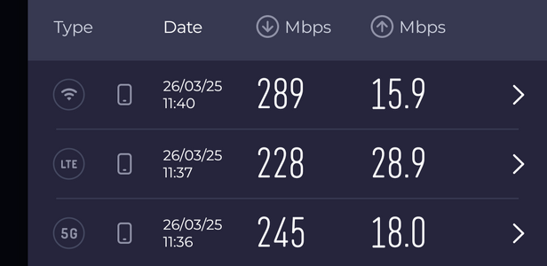

I often see speeds way in excess of what the mini can produce, just using a decent 5g mobile router.
Today through the mobile router with 4 and 5g from the phone below.
Cost is £7.50 a month 😎
