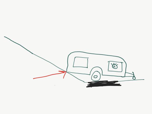

The first one, and something which I’m sure is very often overlooked, is an issue which arises from the transition from level ground, to the start of the slope of the driveway, and in your case, you say 1 in 5, which is a considerable gradient of 20%.
Depending on both the length of your caravan, and how and over what distance the ground changes from level to a 20% gradient is a very important factor. If the transition is rather short, and if we take an example where the van is introduced to the slope rear-end first, it could be that even when the jockey wheel is wound all the way down so as to lower the front of the van as much as possible, in order to raise the rear of the van as high as possible, it may be that the rear of the van would hit the ground of the slope before the wheels have begun to ride up the slope. In this case, it would be just as much of a problem if the wan was to be introduced to the slope tow-hitch first, but it would be the tow hitch that would hit the ground, and not the rear of the van.
A bit like this ... (As you can see, I’m no artist !)
Of course if the transition is a gradual curve, then this problem may not exist.

Your write about your diagrams :p but not bad but would it not work if he put some wood or something under the tyres as he is about to hit the ramp and elevate the van slightly , would that not work ?
As so.... !
But not “rong” about your spelling ? :evil:
As so.... !
If it is a problem, there could be a couple of potential solutions Craig, it just depends on the severity of the angle ...
Waiting for the photos ericmark !
