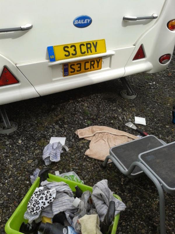

(Picture is our old van) but plate in the picture is now on our new van but when I went to put my newer nicer plate on the van the old plate took nearly an hour to get off because it was well and truly stuck so even with the smaller plate I still have 6 pads on and it's going nowhere !
By the time I had gettin all the old sticky off I don't think I could feel my fingers and thumbs after rubbing ! :eek:hmy:
