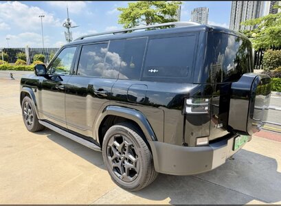

Here is a new BYD Ti7 a 1.5 litre turbo PHEV with 79 miles battery range and 0-62 mph at 4.8 seconds and expected to be priced under £50000. No details of its U.K. towing performance has been released but global models are around 2500kg dependent on market.
There’s a lady near us who works in a fleet leasing business and told me that BYD are the most requested lease cars, but demand is higher than supply.
