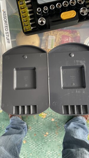

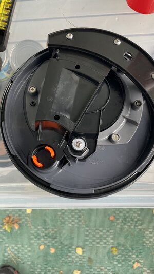

So, the point is that during our current holiday near York in the caravan the mechanism on the Thetford C260 toilet cassette completely failed and a part fell inside the cassette. After a thorough cleaning I removed the mechanism from the cassette and retrieved the broken part, the black component in the top of the picture with two dome headed screws shown, hoping to be able to reattach it. However, the four screw mounting attachments had completely snapped off and were beyond repair. This meant that the circular sealing flap wouldn’t close which presented problems when taking the cassette to be emptied but, fortunately it wasn’t full so no unpleasant spillages occurred.
I found many compatible replacements online costing around £45 but preferred to get a genuine Thetford one which online cost around £65 or a whopping £85 in stock at a place 45 miles away. For another £40 I could get a Thetford Fresh-up kit with a complete cassette and toilet seat. As this was an emergency with a week of the holiday to go, I decided to go for a mechanism costing £45.99 with next day Amazon Prime delivery to the site we’re staying at.
It arrived early the following morning and I carefully examined it. I couldn’t find any discernable difference between the old and new parts. The new one even had the same part numbers in the same place on the main component and the slide. It was quite stiff in operation so, I carefully slackened the retaining screw on the flap mechanism with the white nylon washer under it, which freed the mechanism up just enough. I then the gave the seals a liberal spray with seal lubricant and refitted it into the cassette, it fitted perfectly and I’ve now got a fully functional loo again thankfully.
I then took a look at the broken mechanism before binning it and came to conclusion that I’d been using the toilet incorrectly. I have read discussions on toilet use, specifically if they should be used with the flap open or closed. I always used it flap closed, my wife didn’t agree. However, she’s right, the loo should always be used with the flap valve open as the structure that supports the valve flap is not designed or intended to bear any weight at all which is why the one in my cassette eventually snapped off, albeit after six years.
So, the cheaper replacement cassette mechanisms do fit and work correctly and the toilet should always be used with the flap open.

Whilst emptying my cassette (C250/260) the slidey / flappy door (as shown in your left image) slid off the top of the cassette and disappeared down the drain together all the waste. We were on holiday at the time but fortunately it didn't stop us using the toilet. I enquired about a replacement and was told that I'd have to buy the entire mechanism from Thetford costing £50. Surely not. Amazon came to the rescue at £5.99. I now remove it (slide it off) before pointing the waste tube down the hole. I nearly didn't bother replacing it as I'm not sure what purpose it performs.

Even Thetford say only use the toilet with the flap open. Using closed causes a number of issues.
1. The plastic flap seals on its top not bottom side.
2. The plastic flaps are a weak point .Using closed can stress the flap.Note the weak plastic cog mechanism.
3. Using shut and then opening! Watch the splash back and of course the need to wipe the proverbial Klingons off the flap🤮

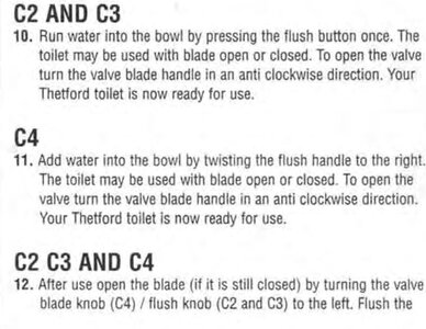

As I said, the problem may be model-specific. Certainly, not all Thetford instructions say to only be used open. The ones I have had, including a Senator, say this.
I would be interested to see where Thetford say it can cause problems.
There should not be a splash back if the pressure equalisation valve is operating correctly.
I also suggested leaving water on the blade as a seal and continuous test. I would still do that, but Thetford advises against it saying it does not improve the seal, (well water seals have been, and continue to be used domestically with great success).
They also say it can lead to flooding, that would have to be explained to me, it makes no sense. But hey ho.
