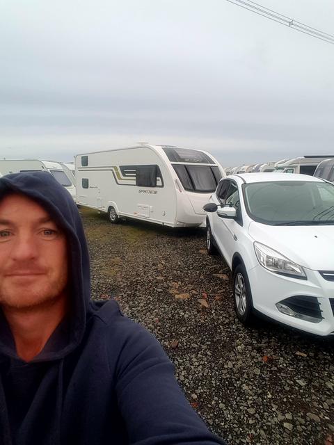

Hi there , we have the Ford Kuga same spec as what you have mentioned as you can see in my profile picture , 65 plate and it is spot on , more than enough power for what you will need and our van is quite heavy and pulls it no brother , it is an ideal tow car towing and not towing with loads of space
