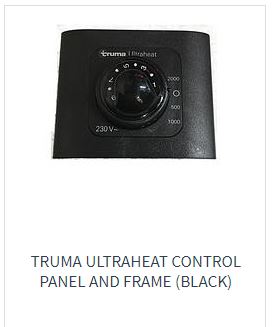

As for the electric heater unit, it has two cutouts mounted on the control box behind the gas fire, a lower limit cutout and a higher limit cutout.
Both are known weak points and if going as far as replacing them, then it is sensible to replace both at the same time.
Have a look here at temperature control and limit : https://www.leisureshopdirect.com/gas/caravan-gas-fires/truma-ultraheat-electrical-supplementary-heater-spare-parts
However, access to the control box usually means taking out the gas fire which in turn involves breaking gas joints and breaking the flue seal.
It is highly important that on reassembly a new flue seal is fitted and that all gas joints are tested for soundness and pressure tested.
It should also be noted that the thermostat for the electric heating is part of the control switch , which if mounted near the fire, or above the fridge, it can be fooled into thinking what the temperature is as the back side of the control switch is in a cavity which is heated and does not cool down as quickly as the main van.
The answer to rectify this is to fit a remote thermostat if one is not already fitted.
If one is fitted it will be usually attached to the gas fire sensor bulb at the front base of the gas fire just behind the front cover.

Yes it does at the back of the inner dial which is why many users find that the heater does not respond to changing temperatures in the van as quickly as it should, as that control is usually mounted into a space behind the wall, such as a wardrobe wall, or similar, where the temperature takes a lot longer to drop compared to the main body of the van, and is why a remote sensor is advised, fixed to the gas temp sensor bulb at the base of the gas fire.
As far as the question is concerned and the loss of the green light on the control panel, that suggests that the transformer which supplies that light, situated on the PCB behind the gas fire in the Ultraheat control box has failed.
To effect any repair will need the gas fire to be removed as it is usually impossible to do anything to the Ultraheat with the gas fire in place, and that means gas tightness testing, new flue seal etc etc.
