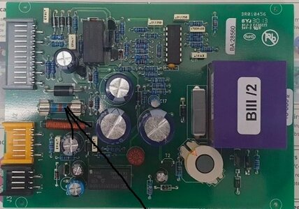

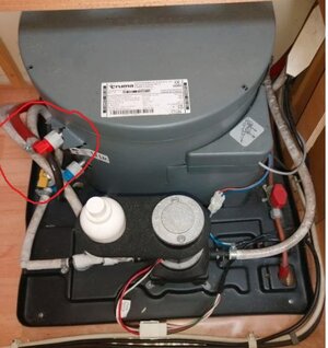

The gas control on the Truma Ultrastore is a pcb located on the RH side of the unit(see photo) under the grey plastic cover with the terminals facing upwards. On it is a small 20mm glass fuse see second photo with black arrow pointing to it.Given you have checked there's 12V power to the PCB it sounds like the fuse may have popped. IF you don't feel confident then the you could contact a mobile engineer (See www.mobilecaravanengineers.co.uk a click on Find an engineer) The PCB can also be repaired see A & R electronics who advertise a repair service on ebay (https://www.ebay.co.uk/itm/156612222014)

@otherclive The OP has posted that neither the green or red LED light up indicating a lack of 12V ( the green lead would light initially and you hear a small 'clunk' as the gas valve opens , then if no gas the valve shuts and the red LED comes on to indicate a flame failure )
