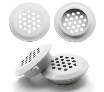

You can buy this sort of thing from Amazon. Lots of sizes and colours, cheap.
