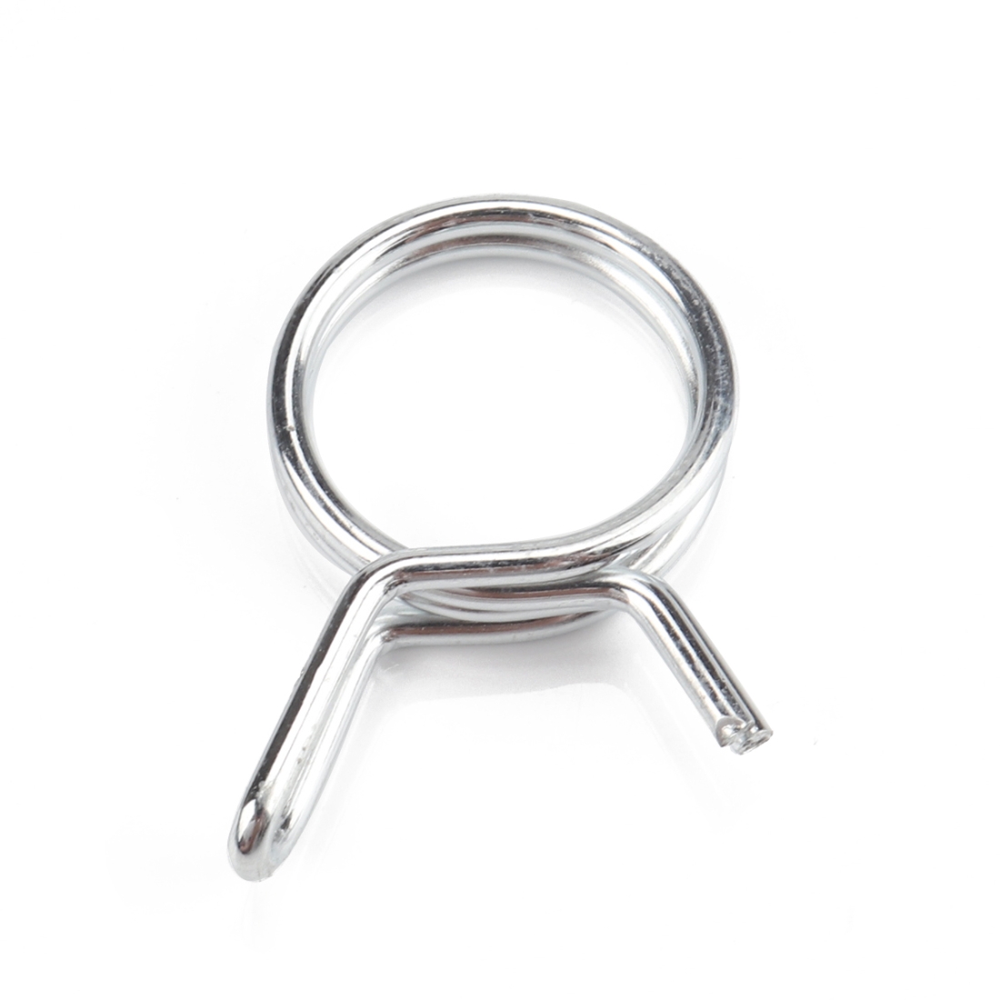

Possibly be better with one of the spring type. Very hard to get to a Jubilee when its right at the back, and of course you need two hands. The spring type can be done one handed with pliers.
