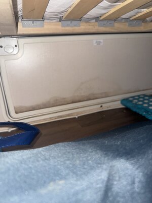

Seen this on a few,it seem to be a failure of the seal/door due to the locking mechanism not compressing the seal properly. On some I've glued a small piece of plastic (2mm thick) onto the frame the lock presses against, then taken damp readings and hopefully next year the are affected will have dried out , but it's a suck and see approach

I had similar many years ago. The inner section of the door delaminated from the frame. Bailey supplied a new door FOC.

No unfortunately not is 2015 swift sport challenger 586
However when was it purchased and was it bought from a dealership? If bought new it came with a 10 year damp ingress warranty, but probably cannot use that?
Seems water is leaking past the seal and if the locker door is wet then there may be damp elsewhere around the door so worth doing a damp test.

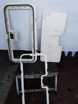

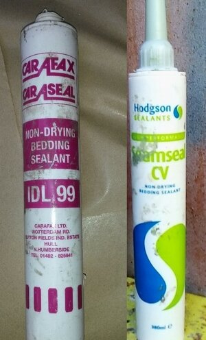

As water appears to be soaking up from the bottom I would suspect the door panel to be the culprit and the place to start - dismantle, thoroughly clean off any old sealant and refit with sikafkex on the exterior surface taking care to wipe off any excess before it sets. Then worth trying dehumidifier like Kontrol or uni bond Aero adjacent in the locker - ensuring these are emptied prior to towing,
