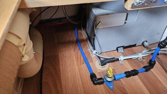

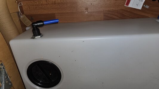

I think what happened was, the previous owner bypassed the internal tank completely and was relying completely on hosepipe water pressure, from where he had it parked next to his house.
What I want to do, ideally is set up my aquaroll with a pump to fill the internal tank and get that distribution system working, independent of what services I may have.

You would need to do more pictures of where all the pipes come from and where they go, showing a couple of pipes that don’t go anywhere doesn’t help in sorting the problem.
It’s a pig like showing three sets of 230v cables and saying how do I get my sockets to work 🤔

I'll try to get more photos, but I can trace the pipe from the hose outside to a pair of t junctions. One goes to what I assume is a gas water heater, as it has a gas line and several red pipes coming out of it. Then there's a blue line that goes along the wall to the bathroom, parallel to a red line. Another blue line loops around the front of the van and along the opposite wall to the kitchen sink.

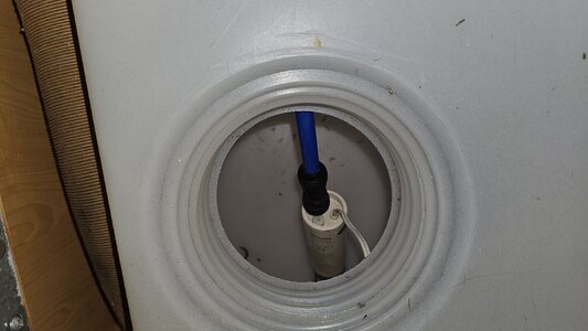

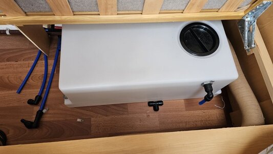

I've been into the internal reservoir and it's got a 12v submersible pump, and something for measuring water level. Pump leads to one of the disconnected outlets from the reservoir.
So it looks like I've got a fully disconnected internal reservoir and a non-pressurised feed that should run the entire water system, if hooked up to a pressurised feed. Don't have a hosepipe long enough to test...
I don't know why the internal reservoir was disconnected, and I don't think a seance to commune with the dead will be productive. I will take many more photos.

if all the electric and water components are there and are in the working condition
then the water tank connection is simply a pipe to the T junction of your external water inlet.
If you have it connected already but it's not working there could be a bypass switch near the water tank itself.
Be aware that testing nobody-knows-how-they-are-connected water pipes can lead to unexpected water leaks. I personally wouldn't risk it until I checked every pipe and every joint.

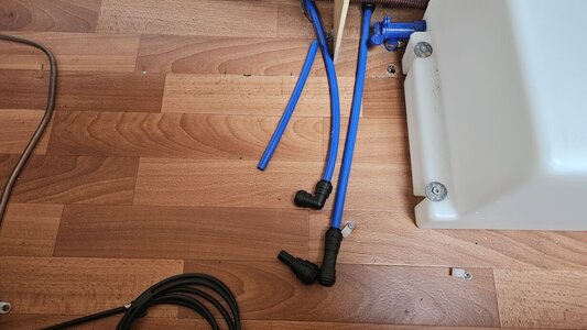

The blue tap at base of tank looks like drain to empty tank.. You only show one pipe coming out of it, should be two one to fill another attached to internal pump.
The yellow tap is drain for system and is show open ie up and draining.

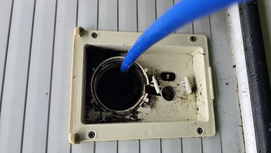

Here is inlet and filter that should go into hole where blue hose is.
Should be two 12V electrical connectors on back of it to power external aquaroll pump.
There should also be pressure switch in system. See link. It fits between inlet and internal cold water pipe. Pump's +12V goes through this switch. Turns pump off when system is at correct pressure. Knob on top allows you to adjust cutoff pressure.
I'd get it working of external aquaroll pump first. Then you can think about plumbing in internal tank and way to fill it from aquaroll.
I'd feed internal tanks outlet through pressure switch and have pressure switch control internal tanks pump.
To fill tank feed external inlet pipe straight into internal tank inlet. Connect 12v to external inlet pump connectors. No need for over flow if you fill from 10L containers ie place aquaroll pump in 10L containers. Only add what you think internal tank can take ie 10L at time. Error on caution side and under fill.
My caravan is feed externally using same inlet. Plan is fit internal tank and fill from Aquaroll using external pump. Not sure if I'll use inline pump of submerged pump to supply water from internal tank.
Can you supply photos of pump in internal tank, how it is mounted, plumbed and wired. I may copy it.

There are a lot of unknowns in this system, so as others have said its not possible to give precise advice.
However there is one major concern about the system you received, and that is you tell us you think the previous owner used mains water pressure direct onto the pipe work, is definitely not a good idea. The appliances will only be rated for about 1.5Bar cold water pressure, Bear in mind that mains water can easily reach 6Bar there is a real risk of pipework joints or valves or appliances being damaged.
The connecting hose may have had a pressure reducer fitted to control the pressure. Hoses are sold specifically for this purpose.
From the pictures, you have either a Carver or Truma Crystal filter input on the side of the caravan. It is clearly seriously damaged and will be unusable. It will need to either replaced with the same unit or possibly adapted to receive a different make of pump inlet.

I was given a hosepipe, but it doesn't have a pressure regulator, just a bog standard clip on hose fitting. You've given some of the most practical information, especially about system pressure, thanks! Gives me more to work with as well as a "what to test and replace" kind of thing.
I've had the suggestions to get aquaroll working first and I think that will involve replacement of the filter unit. I'll add more photos of the internal reservoir as well, but I have had a flare up of one of my several disabilities. So we may need to wait.

Is tank internal pump's outlet that unterminated blue pipe coming out top?. If so where is inflow pipe to fill it?.
You may find one of the long black joiners in middle of pipe section is non return valve.
The photos are little to focused on one area wider angle shots would be handy if you decide to post anymore.
