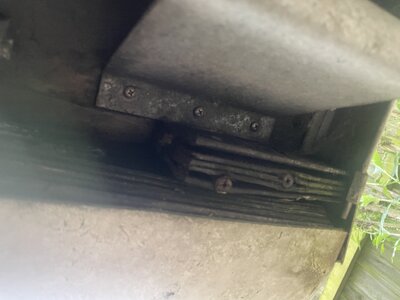

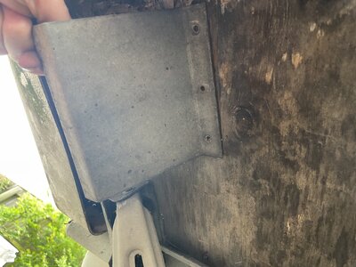

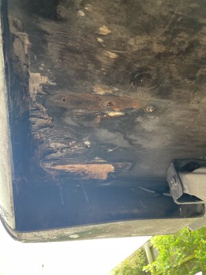

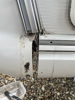

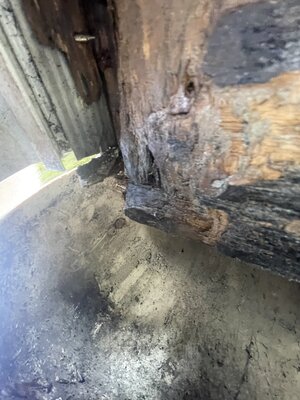

Newbie here having recently got a 2006 bessacar 645 in a private sale. Checked for damp internally with no issues, stupidly didn’t check underneath , but noticed when greasing stand winders there is damp in both rear corners. Inside the rear valance there is a piece of timber upstand. These are in separate pieces for lh, rh and centre. It appears from taking off the rear corner awning rail cover that the rail stops at the bottom of the caravan and drains against wooden floor base and into rear valance which was then be sucked up by the timber uprights that sit in the water this soaking up to the floor piece. The damp meter shows 33% in very corner but only 10% about 4 inches away. It very localised but crumbling outer plywood. Does anyone have experience in diverting the water flow lower to prevent further wetting of floor. I have removed sodden and crumbling timber uprights which were serving no purpose other than giving the valance a bit of support. And removed the corner steady to allow wet rot treatment of the corner. Now looking to divert water lower. Was thinking of securing a piece of plastic /pipe to channel the water lower . Seems a daft flaw in design to introduce water to the timber floor base.
Any help greatly appreciated.

Oh dear,
The problem with damp, when you can see it it's almost certain that its spread a considerable distance unseen, so you really need to survey and establish exactly how far it has affected any of the absorbent materials.
Its not possible to advise on the detail of what needed just from your description and photographs. There are a number of people who have done YouTube video's about repairing damp affected caravans, but whether its entirely relevant to your challenge I couldn't say.
All affected areas need to be removed and sometimes just a bit more to remove any possibility that wet or dry rot spoors remain. All the affected timber needs to be replaced with treated timber.
When done properly a repaired caravan can be fully serviceable but it may still show signs of the repair. and it will almost certainly have a reduced value.
