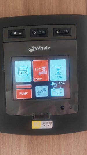

Hi Does anyone know if this is correct . Only the pump motor is running all the time. Had a look at the manual and it says the bar comes on when the pump is operating, but the red bar does not go off unless I turn the pump off ,hope this makes sense .20240623_104354.jpg

The pump is running all the time because the system is not turning it off. If, as is normal nowadays, you have a pressurised system. A sensor should turn the pump on and off to keep a certain pressure in the pipes. Said sensor might be faulty, or in need of adjustment. Or there may be a leak in the system.

I suspect John’s last sentence is the answer. An air leak. Is your pump in the aquaroll or onboard?
The plug socket from aquaroll to caravan contains O rings which fail allowing air to enter the system causing the failure of pressure build up , thus the pump continues to run.
Check all the joints.
Otherwise it will be something else
