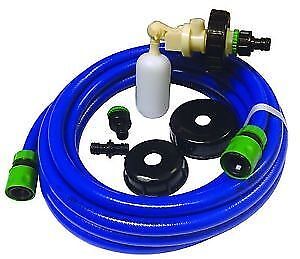

Hello, hope someone can advise. Our Bailey has a Whale water system & our Lunar had a Truma. We still have the Truma long hose with the pressure reducer, question is, can I change the inlet head (not sure if that's the right term) for a Whale one to save buying a new Whale hose with one already fitted. I can't find any Whale inlet heads anywhere so maybe that's telling me something? I kind of begrudge paying £50+ for another which is the same but different.
Or should I just go for the ballcock system that fits in the water container?

Personally I would use the aquaroll system with ballcock.
I have seen Whale to Truma adaptors but not the other way around.

Thanks Damian, typically of me I found a similar thread after I'd started mine. The ballcock system makes much more sense as far as failures go.

We have always got on well with our aquaroll system on serviced pitches having bought a generic for just over £20 - you can decide on the hose length you require and whether you want ordinary or roll-flat hose, in case of an issue the aquaroll would overflow onto the pitch without any caravan damage! We also bought a circular zipped storage bag to keep it clean and make sure no bits went astray. Similar to this one sold as a complete kit:

Just on point, make sure the ballcock is in the vertical position, so it can move up and down. I usually just have a look through the top.
Fitted mine once, off centre, in about the 4 o-clock position over flowed the container.

Flooding can still happen with ballcock system as the aquaroll will continue to fill while the mains water tap is on. We use direct mains water feed.
As long as the pump is not calling for water the worst that can happen with the aquaroll system is the pitch will be flooded and not the van !!!!!
So, as long as you turn the pump off when leaving the van for any length of time you will be fine.
