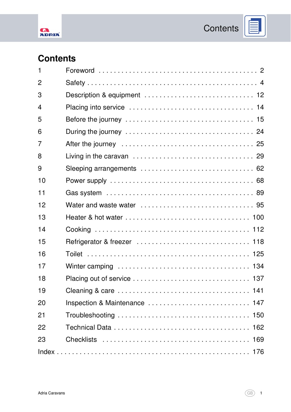

I Google’d this and found this odd link.
No idea what the initial bit about Eurapean vans needing an extra gizmo for towing, but it does mention the fuse locations further on.
Have you tried to Google it?
Hi John, thanks for that, I have the same upload already, it says the fuses are under the bed, and there vis one that is difficult to find within the toilet waste compartment. Found the difficult to find one, I cannot see anything under either bed. been on Google, mostly Australian forums with different versions to the UK model.
I will remove everything in and around the beds tomorrow, I am no rocket scientist, but I aint dumb either, its got to be there somewhere. lol,

This link may help, around pages 70-80. But I don't know what year the manual is for.
