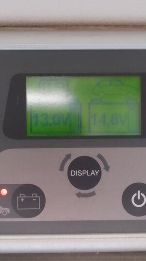

Hi, looking for help. My caravan 12 v lights , pump etc will not work. When I turn the charger on they work for about 1 second then go off. Battery is fully charged, the control panel is showing 12v from car even though the car is not connected. Can anyone help please,

Thank you for your reply, you are correct I never gave enough information. My caravan is a 2009 sterling onyx elite . Everything was fine until 2 weeks ago when all the things that work of 12v stopped working. I got told it was the charger , so purchased a new one. Still the same problem. Nothing will work if I don't switch the charger on. It's the only way the 230v sockets, lights and fridge will work. If I turn the mains off and turn it back on again, the 12v lights come on for 1 second and go back off again. I have tested all fuses , tested the output of the charger, which is reading 14.7 . The control panel above the door is showing that the battery connected is from the car, but nothing works. When I turn the mains power on I hear clicking noises for a couple of seconds, but that's it. I am a campsite warden at the moment and finding it hard to get a mobile guy to come and have a look. I am in Lydd in Kent.

Hi there, yes nordelectonica is the make of the original charger. And the new one is a Sargent px310

There is definitely something very strange if the state of the charger affects the mains 230V sockets. For obvious reasons the charger can only work when mains is available to power it, but the availability of mains should not be affected by the charger being on or off.
Unfortunately equipment manufactured by Nordelectronica does have a reputation of failure with weird symptoms, and it will mean all the Nordel... gear will need removing and repaired or replaced. I believe this is usually all connected with plugs and sockets, and manageable by a person with modest DIY skills. Take pictures to show each connector and colour scheme to refer too.
