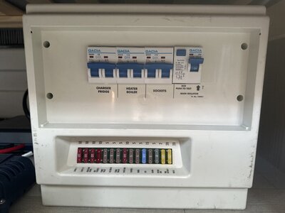

My initial thought when 90 to 120W was mentioned was that's about what a fridge would consume, but that would not be continuous as the thermostat would interrupt, power from time to time. and it would be a more consistent value as its a resistive element. Battery charging was my second thought, but even then 90 to 120W is a far too much of a power drain when the battery is full. Even an older (i.e. not "smart") charger was running I would be very suspicious if it drew that much power in standby.
There are not many mains appliances in a caravan, and none of them should draw mains power when switched off by their own controls, so I'd suggest switching off every mains appliance you can, and if possible unplug them, then check powe units power consumption again. It should be zero. If it's not then it menas there is a problem with some items somewhere in the caravan and it needs to be checked out.
Hopefully there will be no power consumption, at which point reconnect or switch on each mains item appliance and check the consumption until you find the one that causes this parasitic power draw. then you'll know which item it is and you can decide what's to be done.

Thank you ProfJohnL,
I was just going to flick off the one that says Charger/Fridge here but wasn’t sure.

The problem Birty has is not with any 12V appliance in the caravan, but with a power draw on the mains 230V ac system, thus the comments at #14 -#15 & #16 are not relevant to my previous comments.
I think your on the right track. If you switch all the MCB's off (Charger/fridge, Heater Boiler and Sockets) that should isolate all mains appliances from your Bluetti power station. If it doesn't it means someone has messed about with the mains electrics wiring and you would need to get that repaired.
However assuming all the MCB's do isolate the circuits, try turning each one on, and see which of the circuits causes the power draw.
If the draw is while off grid, how will that help?
The OP told us in #1 that he is using a Bluetti connected to his EHU. You may not know, but a Bluetti in this context is a battery powered 230v ac inverter system commonly known as a "power station" They come in different sizes and different makes (Ecoflow is another increasingly common brand). They can be recharged by solar, 12V or mains power. They usually have quite comprehensive power usage information, which is how he knows there is a 90 to 120W power draw.
Birty is using his Bluetti as a source of 230V ac for his caravan whilst of grid.
