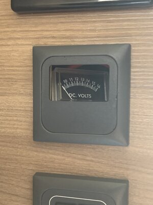

Adria Adora battery gauge cover
Insert a fine screwdriver under the middle of each side and gently lever it up to remove the bezel, then the gauge can be unscrewed from the panel. Use a sheet of paper under the screwdriver to protect the panel.
Hi Roger
Many thanks, thought that might be the case there are some rebates on both sides and think bottom also on the inside of the cover. The guy who had the van before looks like he tapped the gauge because he thought it wasn't working so the battery level gauge has fallen back inside the void as it was held in place by sticky pad only, it was the battery that was duff not the gauge Didn't want to force that cover off unless it is supposed to come off.
Cheers
It looks like a standard sized analogue volt meter,,it maybe possible to replace it with a digital meter if yours is damage,look on line they are not expensive
