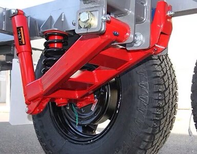

A friend of mine in Australia has a pretty rugged caravan that they use for trips on challenging tracks, or no tracks. He tells me that trailing arm suspension with coil springs and shock absorbers is well regarded for reliability and performance. His has Alpha suspension an example shown below. Might just cope with British roads.
