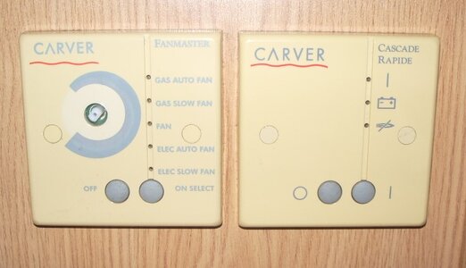

Do anyone know what the one on the right is for i have only seen the botom light red and dont know what the other lights are for ore what thay do lol IMGP3447123.JPG
Just to add to the above, You have teh Cascade Rapide model, which is a water heater which can be heated by either or both Gas and Mains electric. The Right hand panel only controls the gas side of the water heater, and the top green LED indicates the heater has been turned on and is operating correctly. The middle Yellow LED indicates if the caravans 12V battery voltage is low, and it also turns the heater off until the voltage level is corrected, and teh bottom Red LED indicates the heater has tried to light but it didn't sense a flame so its has shut down.
The mains electric side of the heater should have a normal domestic type switch panel somewhere near the heater with a switch and fuse, and it should be marked as "Water Heater" and i t may also have a neon indicator. but not all caravan or motorhome manufacturers followed that advice.
