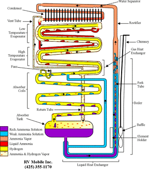

The box you have shown (and there are several similar products from other manufacturers use the Absorption process to cool the box. This is the same technology a the fridge you probably already have in your caravan. Its near silent, and can use LPG, 12Vdc or 230Vac power to operate. They are distinctly better and able to cool quicker and further than the cool box coolers which use a Peltier chip and a fan.
As with all types of fridges and freezers, their ultimate performance is affected by the ambient temperature of the atmosphere, and the appliance manufacturer should tell you about the optimum temperature range the appliance should work in.
There is a third type of fridge which can be found for mobile camping which uses the same compressor technology as a normal domestic fridge. These are by far the most efficient, can cool the furthest and have a wide ambient working temperature range but due to their size and weight they are not used as frequently in camping or caravanning applications. Roger L's suggestion of the table top wine coolers is good but you must make sure its not a peltier device.
Peltier devices usually have a plastic moulding inside the fridge with a fan inside
The unit you have indicated is be quite a margin better than the peltier cool box. and will be quiet.

I bought one which is 60W uncontrolled so built a controller and temperature/battery voltage monitor which controls it down to temp ( about +5 Deg C) and switches off if the battery drops below 12.2 V. when it's hot in the awning I tuck it under the caravan ( behind the draught skirt) as it's a lot cooler under there. just wish if I could figure how to vent the caravans fridge top vent out of the awning.

Many versions of this adsorption fridge, we used them in the awning without a problem for years. Silent and more effective than a cool box. Not as effective as a condenser fridge. But you would hear that all through the night.
A couple of typos?
"Adsorption" should be Absorption - which describes the process used by the fridge.
The "condenser" is a physical part of the refrigeration circuit. Its a heat exchanger that gets rid of heat from the refrigerant fluid usually on he outside back of the fridge, causing the refrigerant fluid to phase change from vapour to a liquid by reducing its temperature. This process is common to both Absorption and Compressor type fridges.
I suspect you meant Compressor not condenser.
